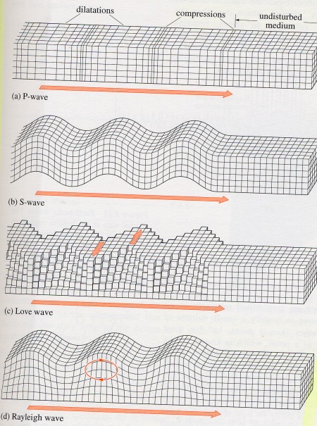

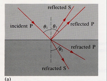

I'm afraid that Alan has over-simplified the case of wave motion through the material of the guitar.
When a seismic event takes place in any material (plucking the string) a series of different wave forms are set up that propogate through the material. These take four main forms:
P waves or pressure waves, that cause a compression/dilation effect as they propogate.
S-waves or shear/transverse waves that cause a motion of the material as the waves passes through it at right angle to the direction of wave travel (either vertical of horizontal).
Love waves, which like S-waves involve shear displacement, but differ from S-waves in that the displacements are only horizontal and that the amplitude decreases rapidly following the event.
Rayleigh waves, are rather like ocean waves in that the pressure form within the medium through which the wave travels passes in vertical ellipses. As with Love waves, the amplitude rapidly decays.
The problem of wave propogation through the material of the guitar is further complicated by the fact that the meterials used in its construction are not homogeneous either within themselves or from material to material. This will cause both reflections and refractions of the traveling waveform both at the junction of differing material and at density boundaries within each material (grain lines), particularly for S and P waves and their complex sets of harmonics. This is not dependent on wavelength, but will effect each part of the wave as it crosses a density boundary.
Diffractions of the propogating wave will also occur at point junctions within the material causing interference with the propogating wave, and some loss of amplitude.
